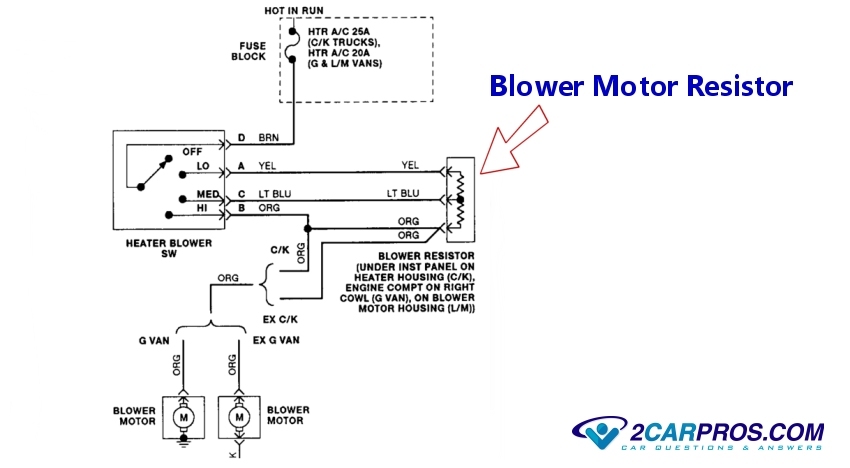

When the blower fan is switched onto high speed the circuit is a straight connection from positive to negative battery power, but when the motor is switched onto the lower speeds electrical power is routed through a series of resistors or a solid state speed controller assembly that drops the voltage down to 6 volts, 8 volts and then 10 volts (low, medium low, medium) which in turn makes the blower motor turn slower.
When these parts burn out due to age, or the blower motor, which is pulling excessive amperage due to the blower motors age which will cause the resistor or a solid state speed controller to burn out.

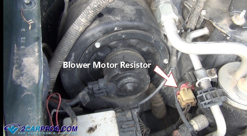

The location of this resistor or speed controller will be inside the air ducting near the blower motor itself which then cools the unit during its operation. Both of these parts are located in the heater plenum box either inside the vehicle on the passenger side, or under the hood mounted near the firewall on the passenger side.

Below is a typical wiring diagram for the blower motor circuit which is basically the same for all vehicles utilizing this system.
2. Remove the fan resistor and inspect it for burn marks which is an indication of failure. If an area shows signs of extreme heat (burned) it needs to be replaced with a the new resistor matches the specifications of your vehicle. Also, inspect the resistor connector for heat damage at the terminals and replace or repair it as needed by splicing in a new connector. Anytime you replace this unit its a good idea to replace the blower motor as well to prevent premature failure due to high amperage draw.
