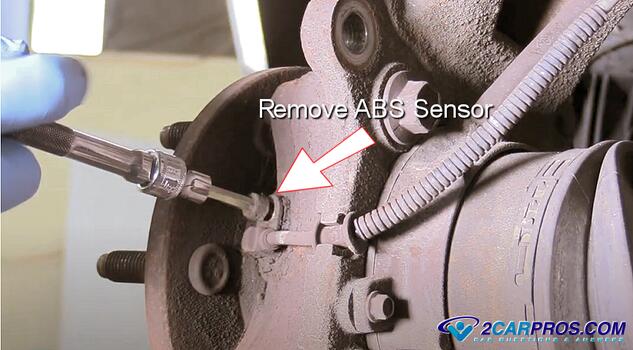

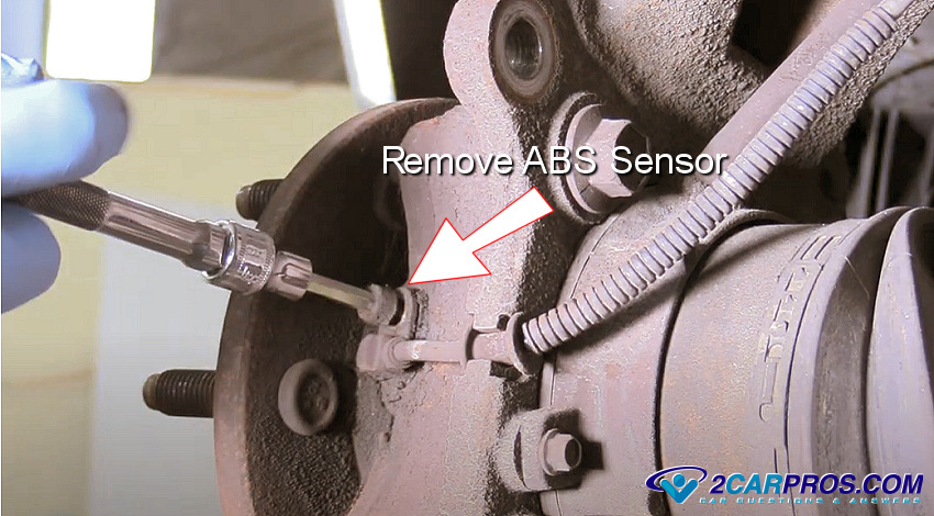

1. Position the steering to gain access to the rear of the bearing hub, is this application the wheel speed sensor will need to be removed which will be the same in most cases.
remove abs sensor from bearing hub

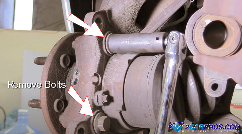

2. The bearing hub will be held to the spindle by three or four mounting bolts, these bolts will be tight so use a breaker bar to help loosen and remove them. You can apply WD40 to the base of the bolt to aid in their removal, avoid getting WD40 on the head of the bolt. The bolts size is 15mm, 17mm and 18mm in most cases, and will be fairly tight so be ready. Position the wrench or ratchet to push downward to loosen. If you are lifting upward it can hurt your back which is no fun especially when you have the reminder of the job to do.
remove bearing hub mounting bolts

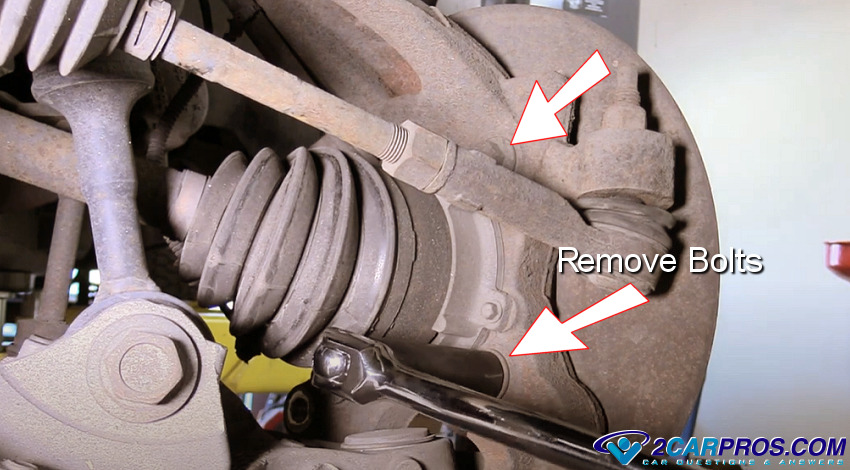

Here are the bolt locations for the front of the bearing hub that must be removed as well.
remove bearing hub mounting bolts front

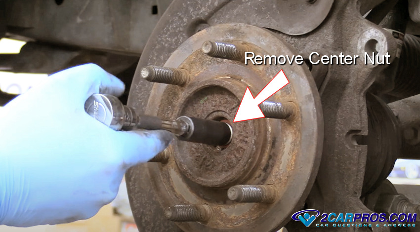

3. Because this vehicle is four wheel drive there is a center nut which holds the front CV axle in place which must be removed, a two wheel drive car will not have this nut.
remove bearing hub center nut

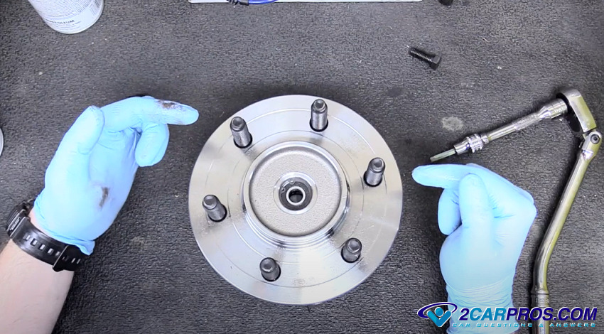

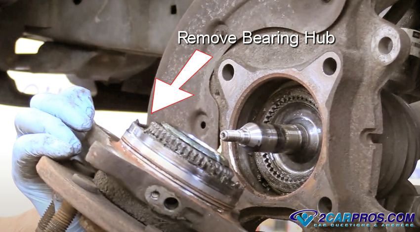

4. Grasp the bearing hub to remove it from the spindle, you might need to tap it using a plastic hammer to break the seal/rust loose.
remove bearing hub

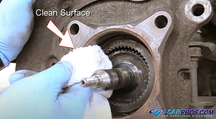

5. Once the bearing hub has been removed, use a shop towel and emery cloth to clean the mounting surface. You want it to be as rust free as possible to ensure the proper installation of the new part.
clean bearing hub mounting surface

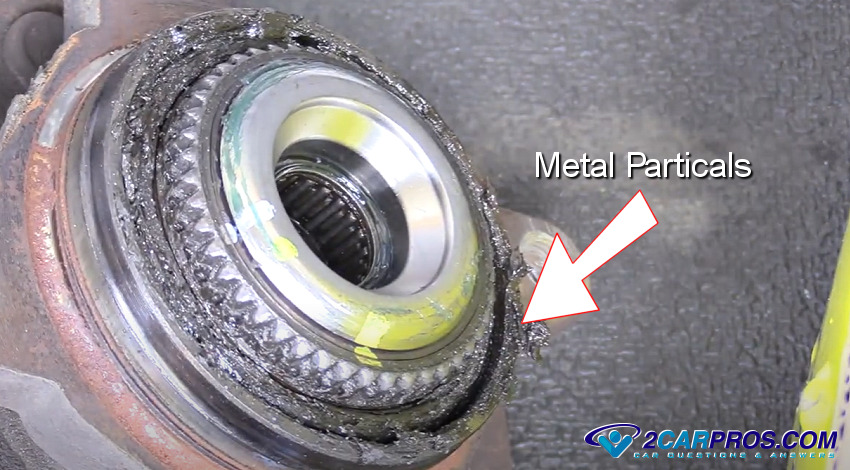

Here is an example of a failed bearing hub, please note the metal particles produced from disintegrating ball bearings.
metal particals

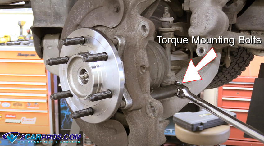

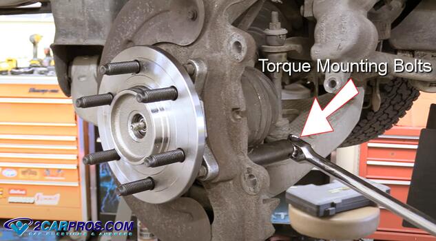

6. Before installing the new bearing hub make sure the match the old part to the new one to ensure a proper installation. Next, hold the hub in place and start all four mounting bolts by hand, then use a torque wrench to do the final tighten in a star pattern which is usually about 55- 70 ft pounds, each application will be different. Refer to the vehicle's service manual for specific instructions and torque specifications. These bolts can be installed with thread lock for added protection against loosening. Reconnect the ABS wiring connector and reassemble the remainder of the job as described in the linked repairs above.
torque bearing hub mounting bolts

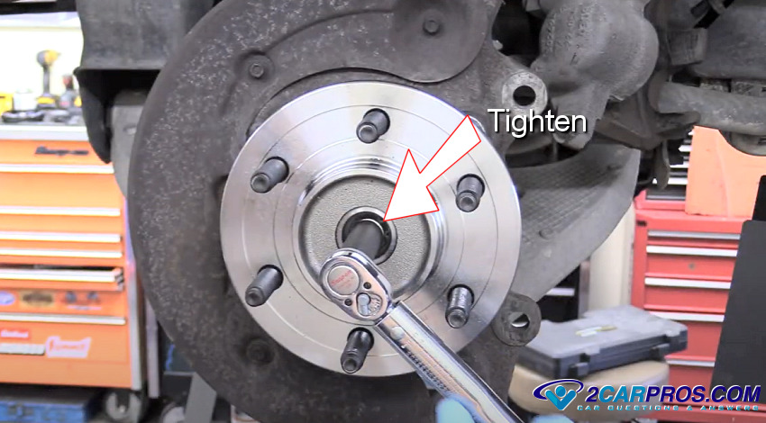

7. Install and tighten the center nut in this case which is a four wheel drive application, this will have a torque value as well.
tighten bearing hub center nut
