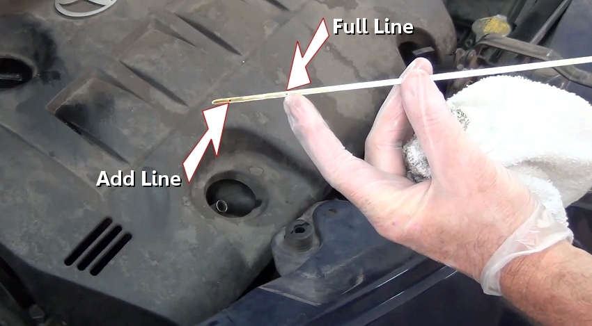

1. Check Engine Oil Level: Your engine relies on a proper amount of engine oil which is important to keep the engine running smoothly.
oil level dip stick

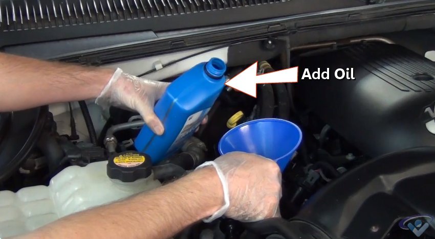

2. Engine Oil Change: If engine service is overdue (dark oil on stick), perform an oil change including the filter, check the engine oil level and add until between the "ADD" and "FULL" indicators of the dipstick.
add engine oil

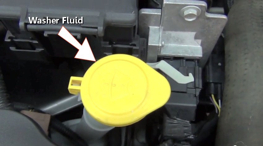

4. Check Washer Fluid Level: Washer fluid (solvent) is used to help clear the windshield of dirt and debris with the assistance of the wipers, inspect the level of the washer solvent and add if needed.
add washer fluid

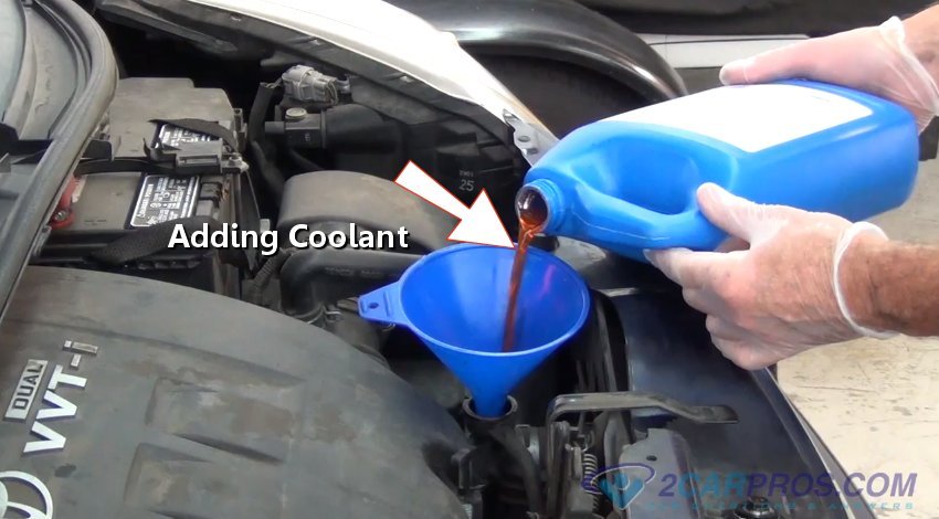

5. Check Coolant Level: This is done when the engine is cold only! Coolant is used to transfer engine heat to the radiator, and to help avoid expansion inside the engine block in freezing temperatures which will cause serious damage. If coolant is weak, corrosion causing acids can form which will cause water pump and gasket failures. Service the cooling system at regular intervals to avoid the negative effects of neglect.
adding coolant

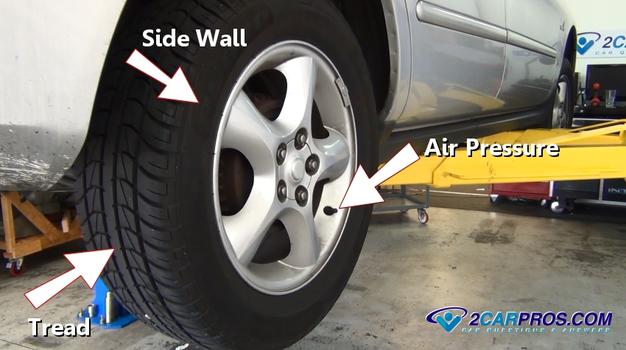

6. Tire Inspection: Good tire condition is essential for driving in wet and icy roads, start by inspecting side walls for cracking and also check the air pressure readings. Additionally, inspect tire tread wear patterns for scalloping which can indicate additional problems such as shock or strut wear. Tires should have at least 5/32” of tread, snow tires should be installed when needed, check the spare tire as well and carry chains in snowy conditions.
tire safety inspection

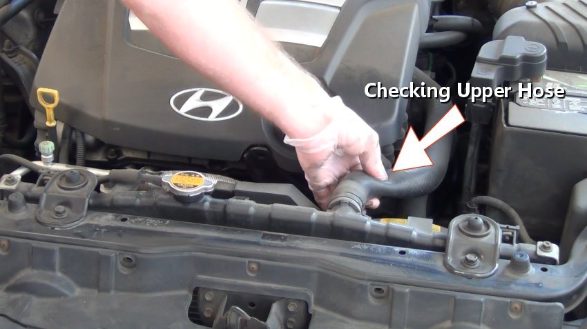

13. Engine Cooling System: Lift the hood and use your flashlight to inspect the engine cooling hoses and the condition of the radiator, you are checking for cracking, weak spots or bulging, these are all signs the hoses need to be replaced. Please visit radiator hose replacement guide for more information.
checking upper radiator hose
