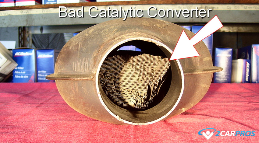

A catalytic converter can fail in one of three ways:
  • Catalyst material wears out and loses it's effectiveness
  • The internal ceramic structure can overheat and break apart
  • Engine oil, antifreeze, or unburned fuel can coat the catalyst preventing its functionality.

1. Low Engine Power: An automotive engine depends on a free flowing exhaust system to maintain its power output. If the catalyst material inside the catalytic converter breaks apart or melts it can cause a partial blockage causing poor engine acceleration. There are many stages of this blockage which will vary greatly, but it will usually be noticed under heavy engine load while slowly losing more and more power.
