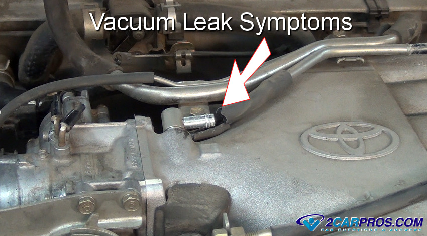

We have created an in-depth, technical step-by-step guide to understanding the symptoms of an automotive engine vacuum leak. A vacuum leak occurs when air enters the engine through a crack or gap in the vacuum hoses, intake manifold gasket, air intake tube or other components. This unmeasured air disrupts the engine's air-fuel balance, leading to a range of performance problems.
