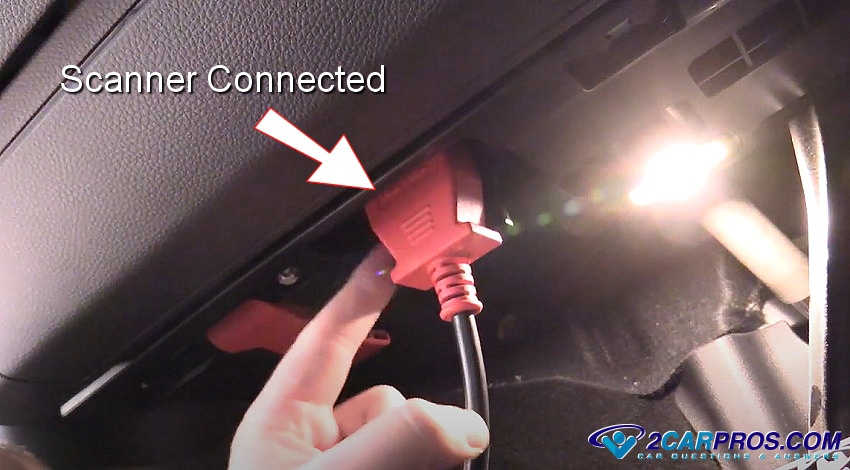

1. The ABS and traction control systems are accessed through the data port connector which is the same one used to gather engine and transmission trouble codes. This connector is located on the drivers side at the lower part of the dashboard, some can be under the dash.
ABS and traction control scanner connected

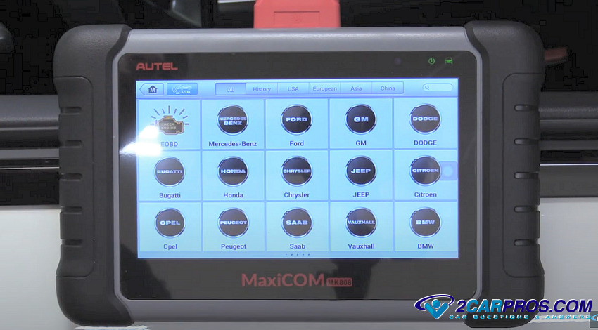

2. Turn the ignition system on to power up the scanner, this will  bring up the first prompt screen with you will be required to input information about the car. Some high end scanners will self detected the car so this step can be skipped.

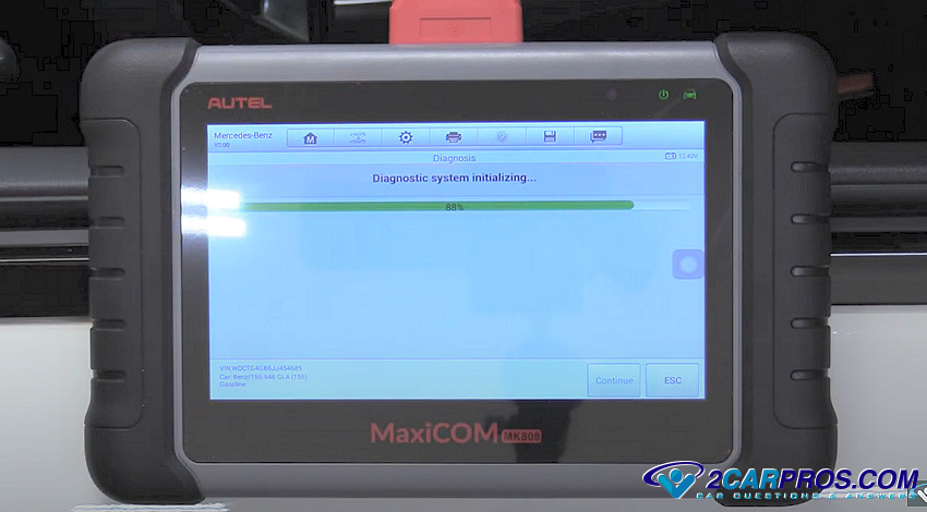

3. Once the scanner information had been inputted you can initialize the ABS and Traction scan code scan, this can take a few moments.
initializing ABS and traction control diagnostic scan

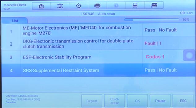

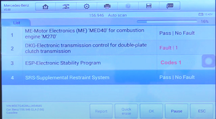

4. After the scan is complete the results will be displayed on the scanner with a pass or fail status which will present the number of codes that are stored in each system. Simply view the codes stored to start making repairs, or see what system will need attention when taking your car in for repairs.
ABS traction control trouble code results
