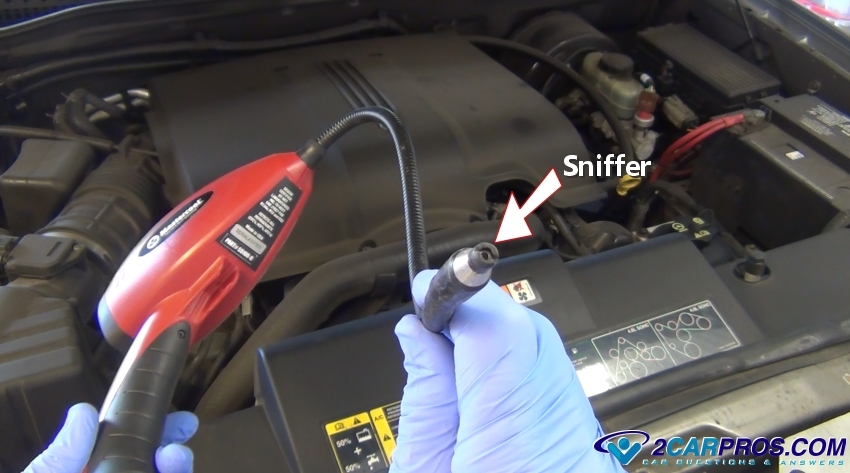

If you cannot hear the leak, or find any oil residue then a leak detector is needed. If you do not have a detector you can purchase one from Amazon from about $35.00. The detector is comprised of a main body which holds a sensing device, batteries, and sensitivity controls. At the end of the detector there is a "sniffer" which is where the detector pulls in a small amount of air to be analyzed for traces of refrigerant.

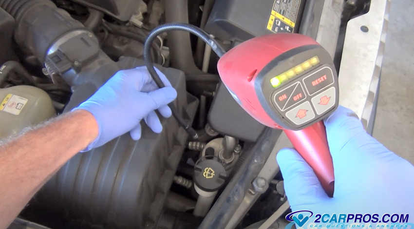

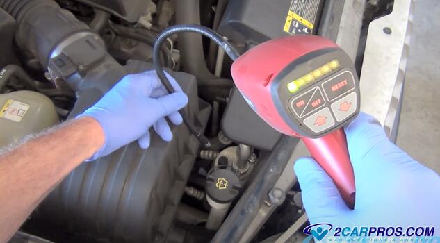

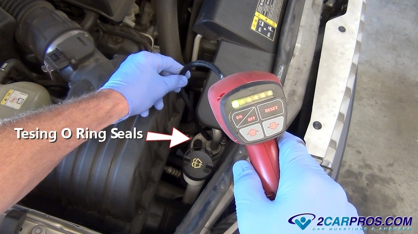

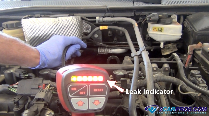

1. Turn the detector on and adjust the sensitivity to the lowest setting to start testing. Here we are testing an O ring seal on the receiver dryer with no response from the detector. O rings are popular places to finds leaks. The tester will indicate a leak by showing one or more red lights while beeping. If you have tested the entire system and no leaks are found, adjust the sensitivity to its higher settings.

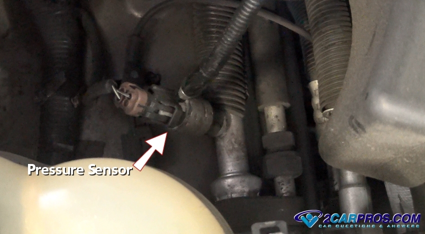

2. Pressure sensors for the system also presents a popular place to find leaks, check at the base and at the electrical connector.

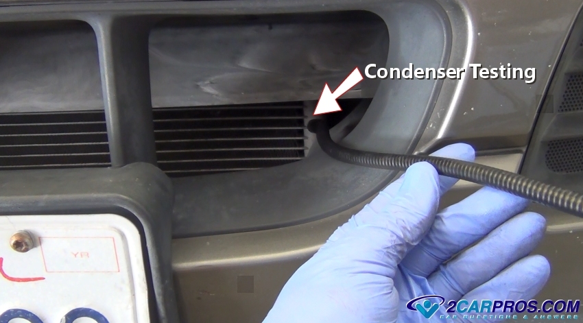

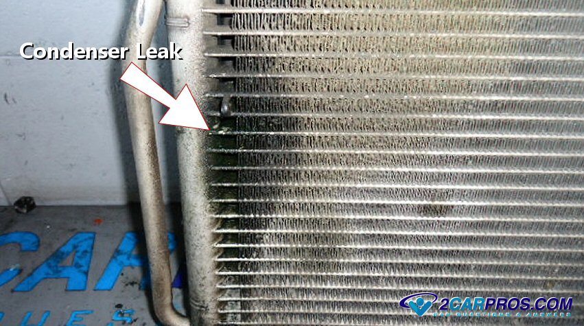

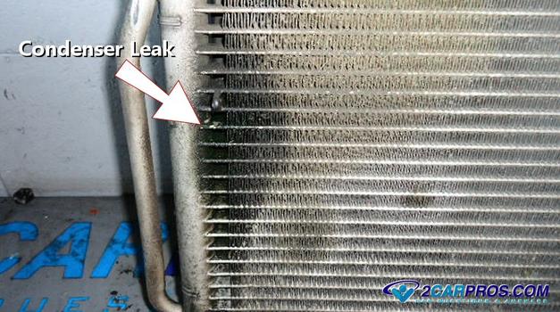

3. The AC condenser is positioned at the front of the vehicle and is subject to small rocks and other road debris which can easily damaged the unit and cause a leak. Check the entire condenser including the hose connections.

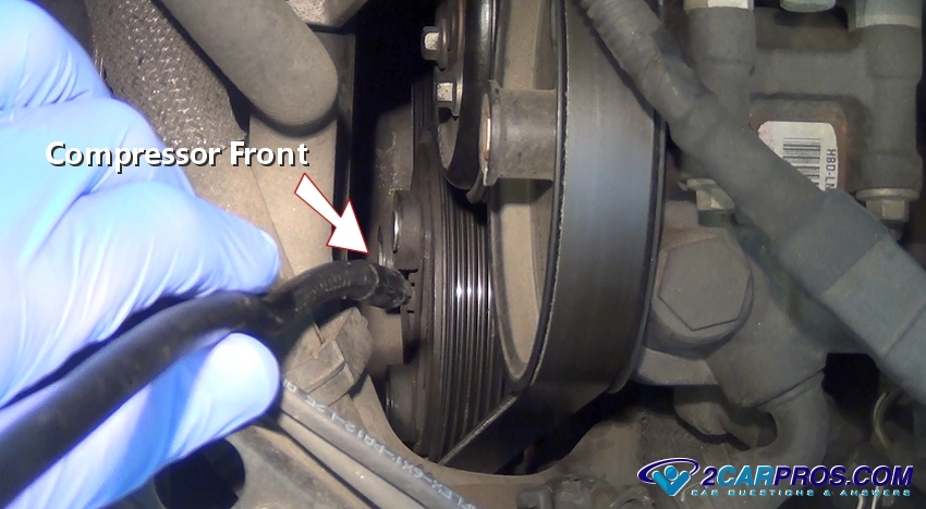

4 . The front of the compressor is where the main shaft seal is located and a very popular place for a refrigerant leak. Position the sniffer in the very front of the compressor, and at the lower part of the clutch or pulley.

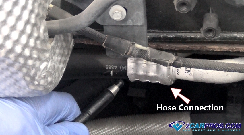

5. Air conditioner hose fittings look like this, which holds the rubber hose into the aluminum fitting or tube. Test at the lower part of the connection.

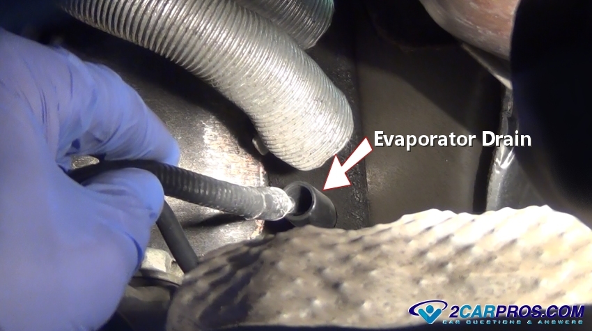

6. Here is the method to check the evaporator of the AC system. Locate the water drain and insert the sniffer, if a leak is detected the evaporator core or the O rings that seal it to the high and low side hoses are leaking. This drain allows the refrigerant to funnel down into the tube which is the best place to check for leaks. Do not get water or dirt into the nose of the sniffer.

7. When the detector has found a leak it will indicate this by beeping rapidly and advancing the red lights on the detector. Before the repair can be made the system must be discharged, once the repair is completed the system must be vacuumed down and recharged.
