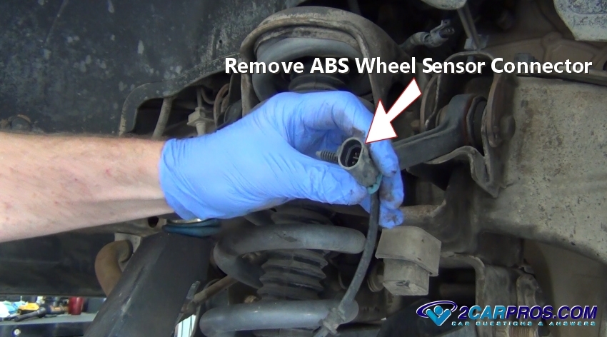

1. Locate the electrical connector from a particular the wheel speed sensor which is near the frame or in the wheel-well in most cases. Don't be confused by other wiring harnesses that may lead down to the wheel such as the brake pad wear sensor. Once located, disconnect the sensor wire at the connector by releasing the safety clasp and gently pulling it apart.

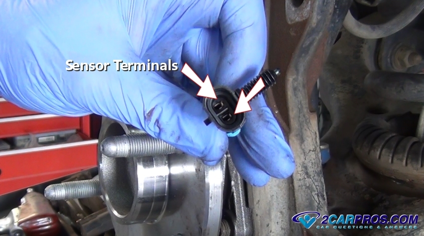

2. Observe the terminals inside the sensor connector, this is where the voltmeter leads will be connected too.

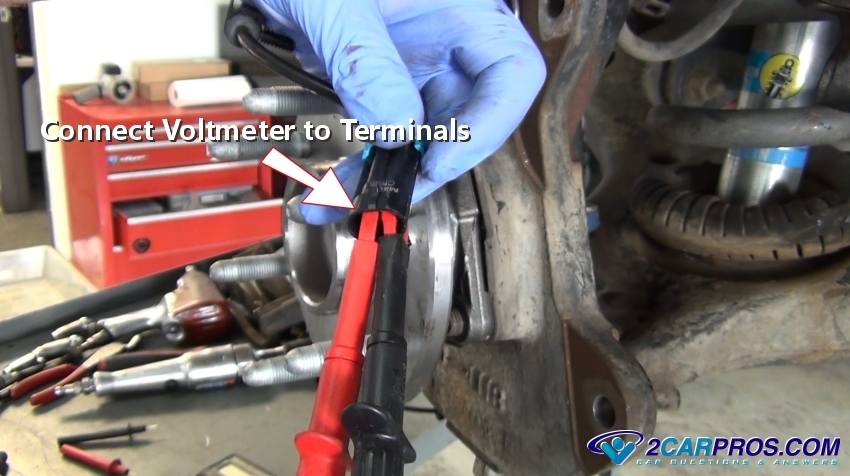

3. Set the voltmeter to AC voltage and use the alligator leads to attach to the sensor connector terminals. Be sure to not allow these test probes to touch together or the sensor will not test properly. Try not to use hand held probes because they can wiggle causing the voltmeter readings to fluctuate which makes testing more difficult and can offset the test.

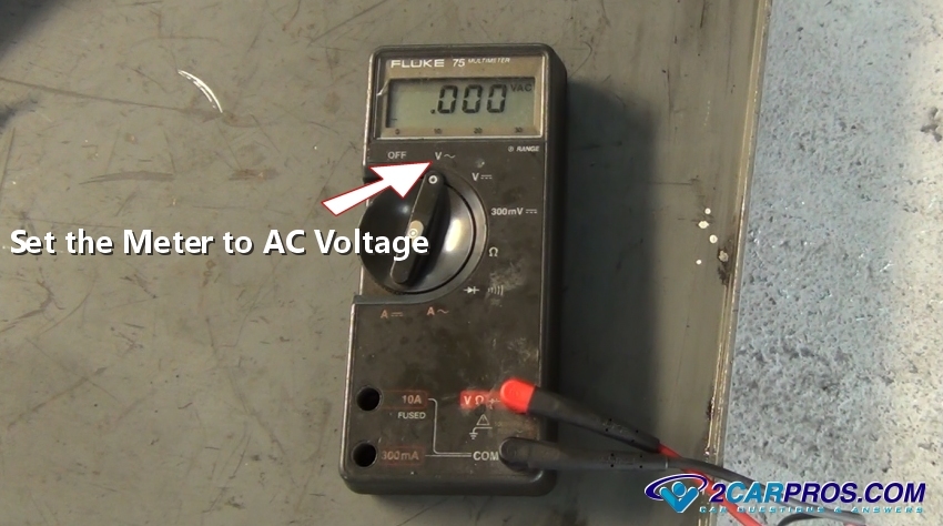

4. The meter will usually indicate AC voltage by a wave symbol. Once the meter is turned on it will fluctuate down to zero volts. Now the sensor is ready to be tested.

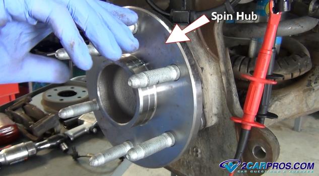

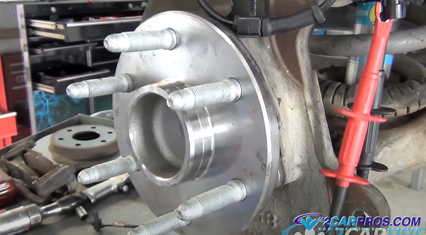

5. While observing the voltmeter spin the wheel or hub to create voltage. This voltage will vary according to the speed in which the hub or wheel is spun. As the hub begins to spin the voltage will rise and then decrease as it stops. Spin the hub or axle which will produce the voltage, if no readings can be found the sensor has failed and replacement is required.

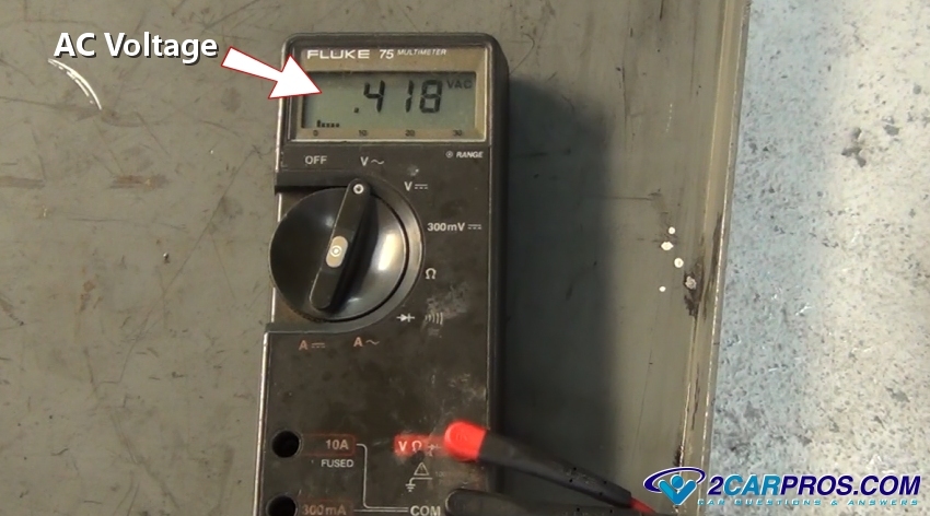

6. This is a typical reading from a wheel sensor, configuration of the sensor mounting is different for each manufacturer but follow the same operation.

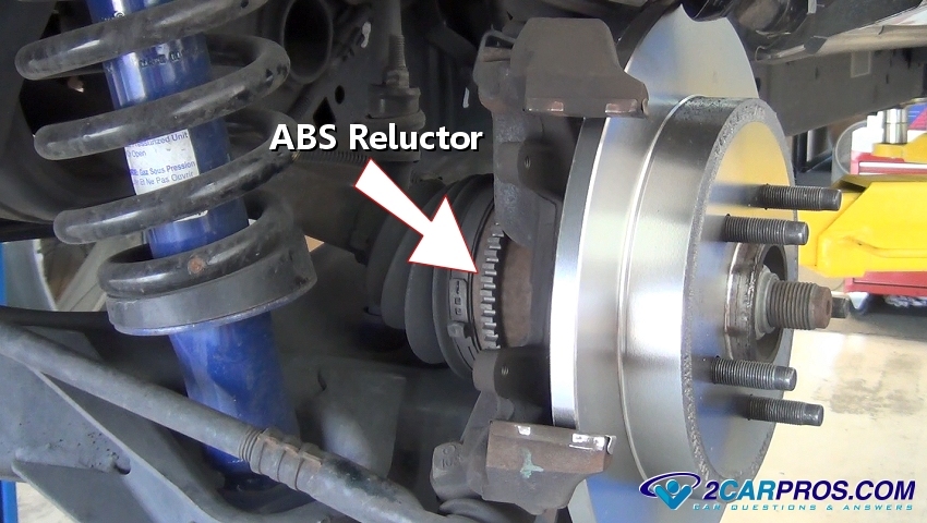

7. In the image below a stator ring or as it is sometimes called a reluctor can be located inside the bearing hub, rear axle housing, or on the CV joint itself. Slowly rotate the ring to check it for damage or missing teeth. Wheel sensors are magnetic so check for metal shavings around the sensor which can hinder performance which should be cleaned off.
