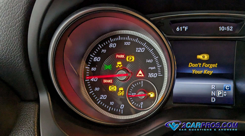

This guide will go over the repairs and what to look for when the ABS and Traction control light come on in your vehicle. We will start with the easy stuff and progress into the more intricate. When these warning lights flash or stay on steadily it means these systems are disabled. Park the car on level ground with the transmission in park, the emergency brake set, turn the engine off. Let's begin!

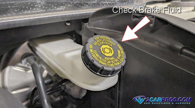

1. Most people don't know this but, if the brake fluid is low in the brake system master cylinder the ABS and Traction control warning lights will come on. Lift the hood to check the fluid level in the master cylinder fluid reservoir.

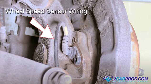

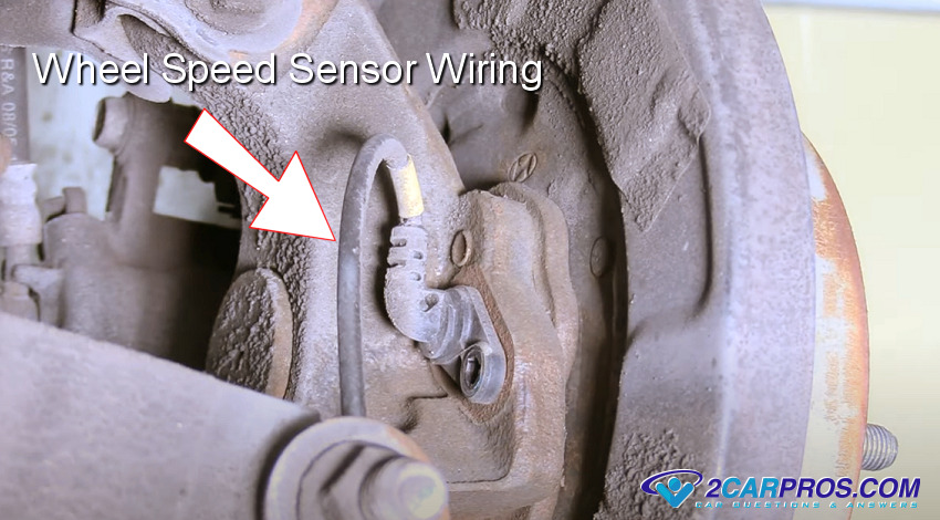

2. Raise the car up to do a visual inspection of the wheel speed sensor wiring, may times road debris or obstacles can tear the wiring from the wheel speed sensor in which case just repair the wiring or replace the sensor.

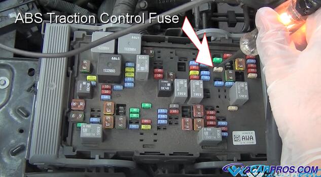

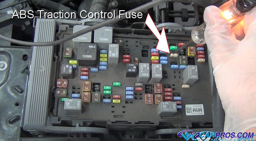

3. Locate the fuse panel under the hood, use the fuse panel lid to find the ABS and traction control system fuses, remove them for inspection and replace if blown. If the fuse blows again there is a short circuit somewhere in the system, which is usually the ABS module or pump motor.
ABS traction control fuse test

Since most of the time the problem will be a wheel speed sensor you can test the sensors manually using a voltmeter. Remove the tire to access the sensor and disconnected it, then attach a volt meter and spin the bearing hub, you should get a small amount of AC voltage.

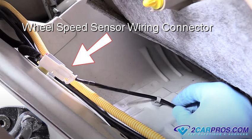

The wheel speed sensor or bearing hub will need to be replaced or wiring repaired. This job is not to difficult and can be done using basic tools and a floor jack.
ABS traction control wheel speed sensor wiring connector

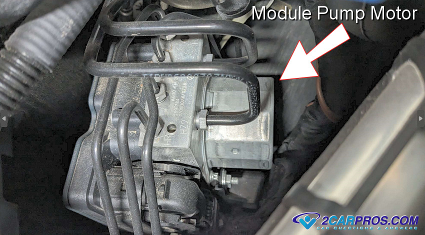

6. If when scanning a code is presented for a ABS and Traction Control Module failure it will need to be replaced. This is common because of the high pressures the pump motor performs during its operation, it can overheat and fail.
