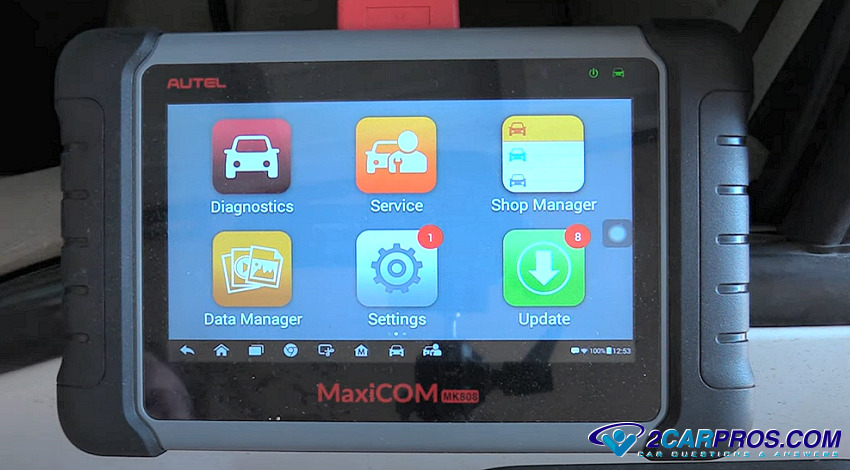

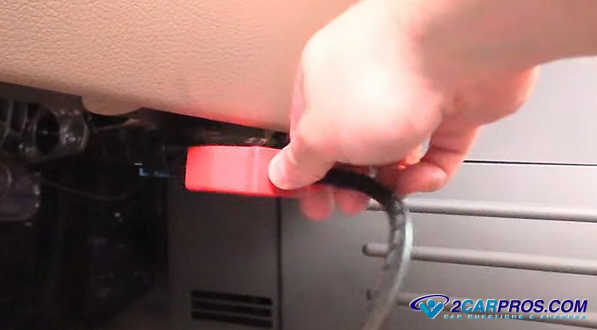

1. Connect Advanced Scanner: A typical engine or drive train scanner will not have the capabilities to access and operate the ABS module control valves which modulate each wheel. You will need an advanced automotive scanner or a scanner bespoke to the ABS and traction control systems. You can find this style of scanner on Amazon or auto parts store starting at about $130.00. Confirm that the scanner is capable of opening the ABS valves before the purchase, then plug the scanner into the ALDL port.
ABS brake scanner bleed
2. Navigate Scanner Prompts: The scanner should boot up, navigate through the year, make and model of your car or use the VIN identification option to load the correct ABS and traction control systems.

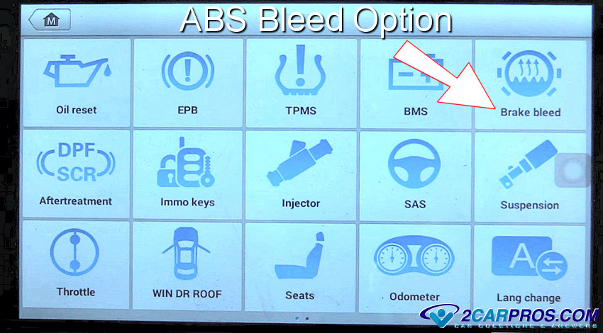

3. Select ABS Bleed Option: The scanner with have a menu displaying various options and capabilities, simply choose the ABS brake bleed option.
select abs brake bleed option

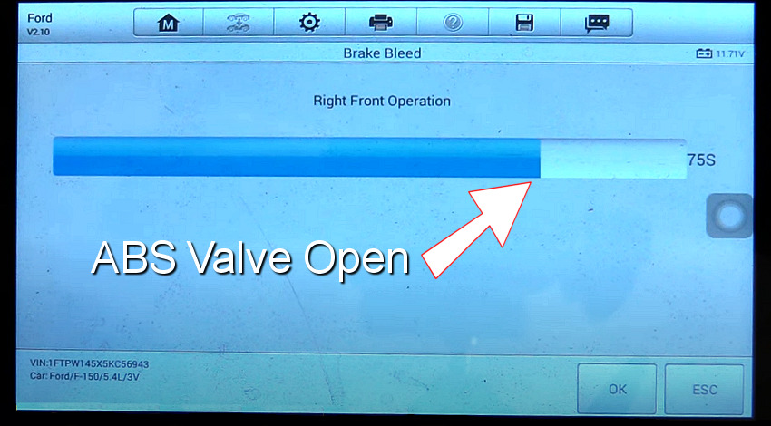

4. Initiate Bleed Sequence: Once the bleed option has been selected, the scanner will prompt you to open a particular valve coinciding with the valve the scanner has opened for service. At this point, bleed the system in the typical manner within the giving duration, this scanner gives you 75 seconds for each valve, (wheel). Continue until the remaining valves are bled and the job is completed.
abs control module valve open duration
