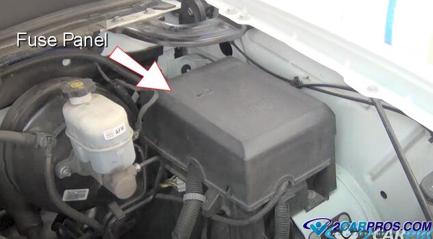

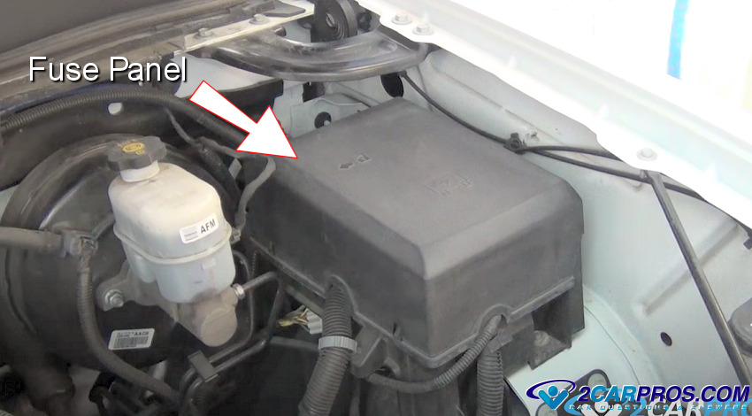

1. Lift the hood and locate the main fuse panel which is usually on the right or left side of the engine compartment and remove the lid, also you can consult your car's owner manual for exact locations. If you still cannot find the ABS-Traction Control fuse location please ask one of our experts at no cost.

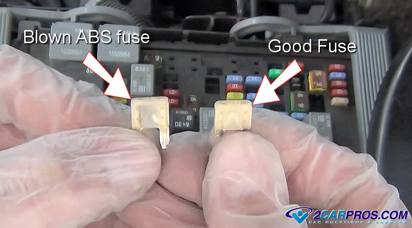

3. Once the fuse has been located simply remove for inspection, grasp the fuse and pull upwards. Check the fuse filament by looking through the clear part of the fuse, if blown, it will be obvious.

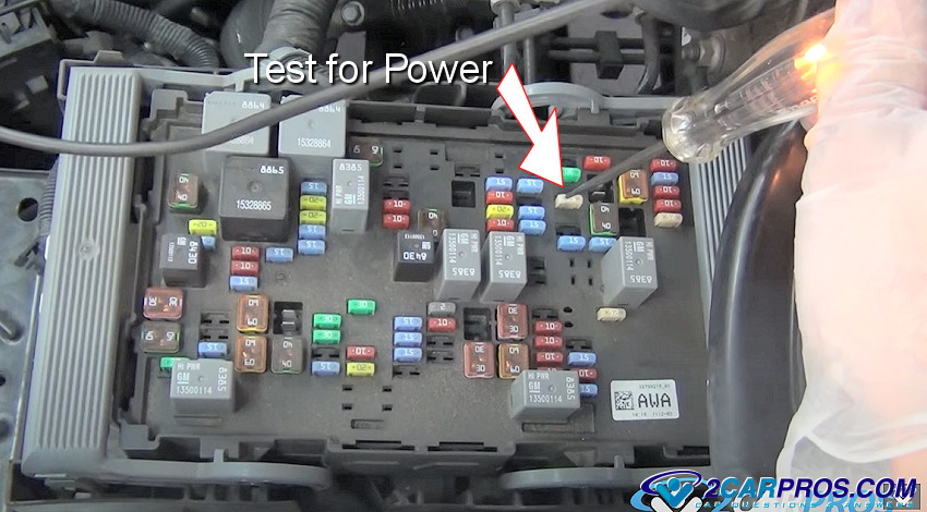

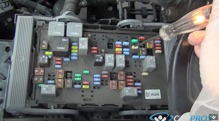

4. If the fuse looks okay then you should check for power at the fuse by switching the ignition system on, this will let you know the fuse and systems are getting power by using a test light.
