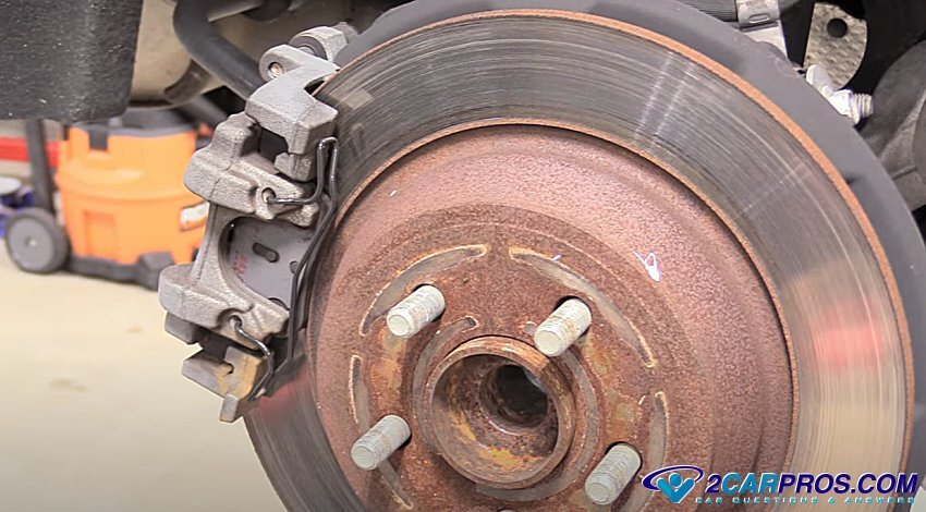

Brake Disc: When a brake disc locks up is it for one of five reasons:
  • The brake pads have worn out enough to where the the brake pad backing plate has fallen between the brake disc (rotor).
  • The rubber brake flex hose has a restriction which does not allow the brake fluid pressure to exit the brake caliper.
  • One of the caliper mounting bolts has fallen out and is allowing the brake caliper to contact the rim.
  • The ABS system control module is malfunctioning.
  • A dual piston caliper becomes frozen over time and the pistons will not retract. (This will usually not happen with a signal piston caliper).
