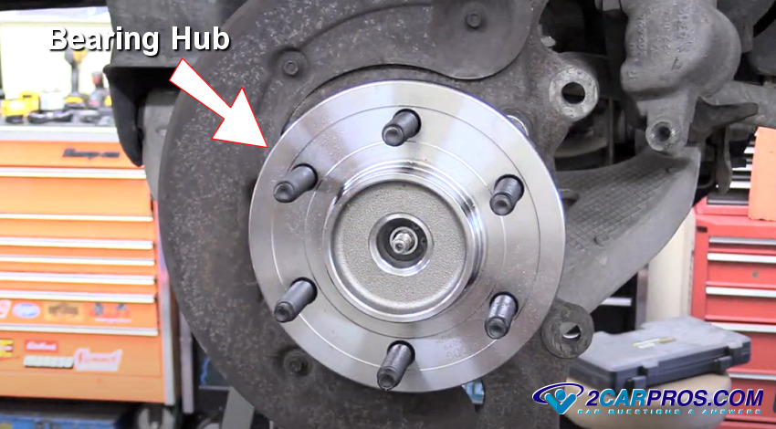

Wheel bearing hubs, or bearing hubs are used to support the vehicle while allowing the wheels to roll, they also can contain ABS wheel speed sensors. In this guide we will go over all you need to know about how and why bearing hubs fail. This is good to know because if this problem is left unattended it can cause the wheel to lock up, pull to one side, and in extreme cases fall off. We will start with the most common symptoms and work are way to the more obscure.

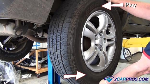

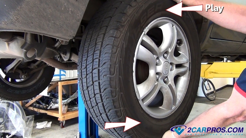

4. Play in Front or Rear Wheels: While most cars have bearing hub in the front, cars with front wheel drive will have them at the rear wheels as well. Sometimes a bearing hub failure will make no noise, got figure, so if when jacking up your vehicle you can grasp the wheel top and bottom and notice "play" in the wheel the bearing hub is bad.
checking for bearing hub play
